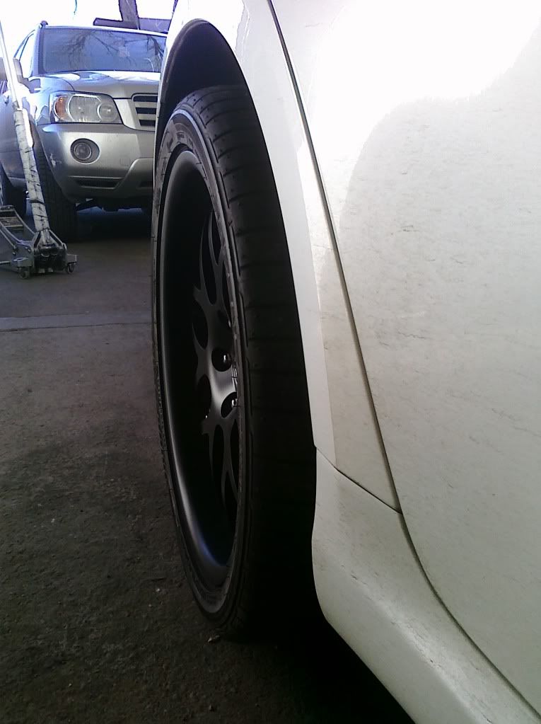

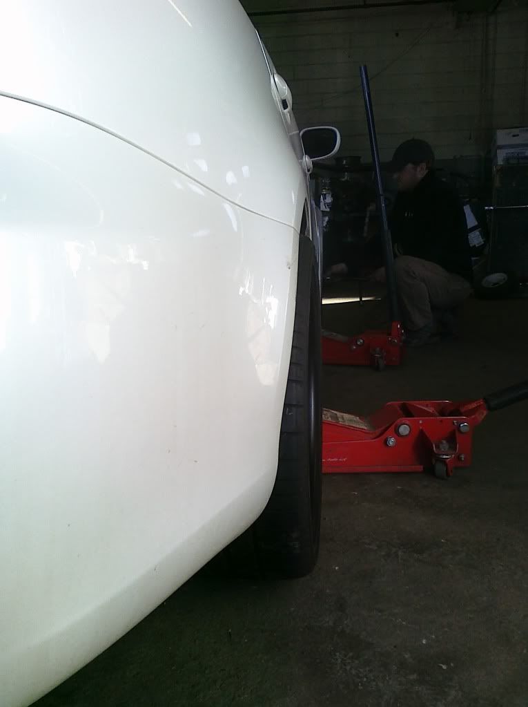

I decided to mount a 305/30 RE050 today at my tire guy to be able to do detailed trimming later on. Suspension not fully loaded yet. phone pics
19x11 2-Piece Forged. I will make this work after I verify my "not so" aggressive fitment :)
Ultimately it may take a mixture of control linkages plus some additional camber, running -2.3 now, to get it all to come together. stay tuned.
