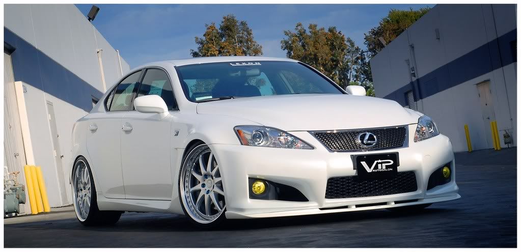

front 245/30-20
rear 295/25-20
What are your rim specs and what tires are you using?
20x ???

WOW look at this
Look at this!
6speedonline.com/forums/lexus/186895-lexus-f-one-aggressive-f-d2forged.html
What kind of work is needed for 295's on the rear's? Looks amazing!
Look at this!
No "work" is necessary to fit 295mm rear tires, only the right backspacing on the wheel.
