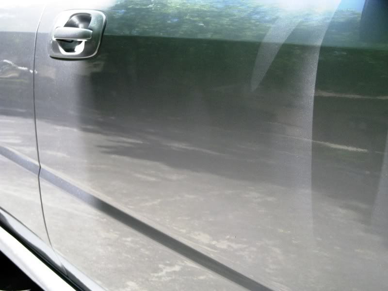

Just for glimps, here is an STi that got too close to some bushes while "offroading". The owner didn't want to pay for a full detail, so I helped him out with a basic wash and some paint correction. Luckily, the scratches weren't deep, just into the clearcoat, and that allowed us to get rid of them.
BEFORE:
AFTER::
