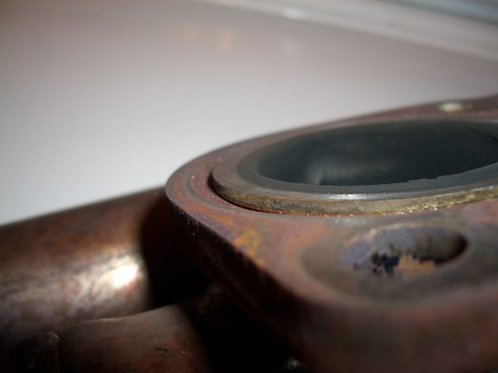

my headers are 100 stock and i need to return to the installer...
already 1 major leak on the driver side (we check the bolt all are tight)
and 2 small on passenger side...
367 hp before and 385 hp after on dynojet!!! after resetting the ecu... but i will return after my double check on the leak
ps... i just hope my headers are not already crack...........somewhere

Are you an engineer doublexl? Seems like you are making major changes to a product without any intelligent background, there derrickhand. I think Sikky knew what they were doing, especially when you see the numbers peoples cars are putting out after their install. You should have left them alone and sent them back if you were unhappy with the product, they even said they would have. Then you could saved some cash and make your own set of headers yourself to "your likings".
sorry eWop313 i am not a math guys here, and i am also not here to say bad word about anybody but my result is 18hp with sikky headers!!!! so the only thing i can say is ???

Dude, I'm afraid you're wrong on this.
Grinding off those cups simply isn't something you should try to do by hand and by eyeballing it. Thousandths of an inch make a difference... In addition, the amount of surface area that now must have a complete seal is significantly increased. With heating and cooling cycles, I think you'll have an issue with seals as a result...
Those cups provide a way to leverage the flange such that the seal is at each port...not along the entire length of the assembly.
At any rate - good luck with the project. Mine will be installed on Monday as received from the manufacturer!
Regards,
Mike
Couldn't have been said better. When installed properly, the way they were designed and torqued correctly they will not leak, guaranteed. If for some reason there is a leak then you need to tighten the bolts correctly.
Doublexl, listen carefully since your past the point of no return. What your doing is going to make the header leak horribly. It would not have had an issue if you would have left them the way they were designed. You need to find someone that has a belt sander. Not a hand held one but a stationary one that is large enough to place the whole entire flange on. You need to hold the flange against it till it is flat again. Since you ground off our welds the only option for you now is to sand the whole flange perfectly flat which could never be done by hand. Just trying to help, but if you don't do this it is gonna leak like crazy. Which it would not have done had you not modified it. The fact that you said a machine shop would charge you $1500 makes it very hard to believe anything you say....that is just plain ridiculous.
Also, you don't want to reset your ecu. That's what you guys getting the lower #'s are doing wrong. What you want to do is just cycle the key. What we recommend is drive it for a while, shut it off for a while. Then drive it again and repeat a time or two. What this does is allow time for the ecu's long term and short term fuel adjustments to take effect. Basically the ecu needs to learn the new setup and make it's adjustments. Or if it's on the dyno, you can literally run the car 3 or 4 times, shut it off and let it cool down. 10 min. run it again and watch the #'s go up. Eventually it won't go up anymore and at that point the ecu has finished it's long term fuel corrections.
how many times do i have to tell you that the flange is straighter now then before i touched it? i went to Sabre Machining, i talked to Tyler Pollock, and asked him what it would take to get this done, and through the conversation he said the cost would likely be another set of headers. when i said so around 1500 and he said that is entirely possible.
they would have to build a jig to hold them steady and flat to put into the sander. he also talked about cleaning up the welds on the inside of the ports by using a circular belt sander.
bottom line. each port is perfectly flat around the diameter in which it will seal to the gasket. is it 100% even across the entire surface of the flange? no, but it is closer then before i started to work on it.
also, you have one customer who has 3 leaks days after his headers were installed. when this cause is determined, we'll see how good your raised welds are. like i said before. the width of the surface you provided to seal to the gakset differed from 1/4" to under 1/8" in some places. and was FAR from round, some are even egg shaped.

I doubt the leaks came from un tightened bolts. It doesn't take a genius to tighten bolts properly. Especially when the install takes 8 hrs I'm pretty sure the mechanics would double or even triple check everything is right before placing everything back together.

Doublexl, there is no need to build a jig to sand a flange?????? To "machine" it in a mill YES, you would need to do so. But why?? I hope your not attempting this install yourself. Based on what we have seen so far this would surely be a bad idea! You do realize that you completely ground off the welds that were put there for a reason. You have basically wasted your time and done nothing but damage a perfectly good header. You say it is flat now but your missing the point still. Look at the pics OEM header caymandiver posted and you will see why you should have just picked up the phone first and saved yourself many un needed hours. If toyota thinks it will help seal on a metal gasket I think it's probably a pretty good idea. We could have explained this in 5 min. over the phone if you would have just called before you went hog wild with your grinder.
Note to all, this should be an example of what not to do. As for the other person with leaks, most likely it is between the header and exhaust. Once again, pick up a phone. Caymendiver had a leak at the header exhaust joint and it ended up being 100% related to the angle of the flange on the early model joe z exhaust he had. He can vouch for this too. With the car running on the lift we simply loosened the bolts and moved the flange down till aligned and re torqued. Done! This is common practice with any new exhaust, header install. As for the bolts being tight, there are a few that are very hard to get a wrench on and might not have been tightened all the way because of this. Either way till he knows where the leaks are coming from this is a pointless discussion.
