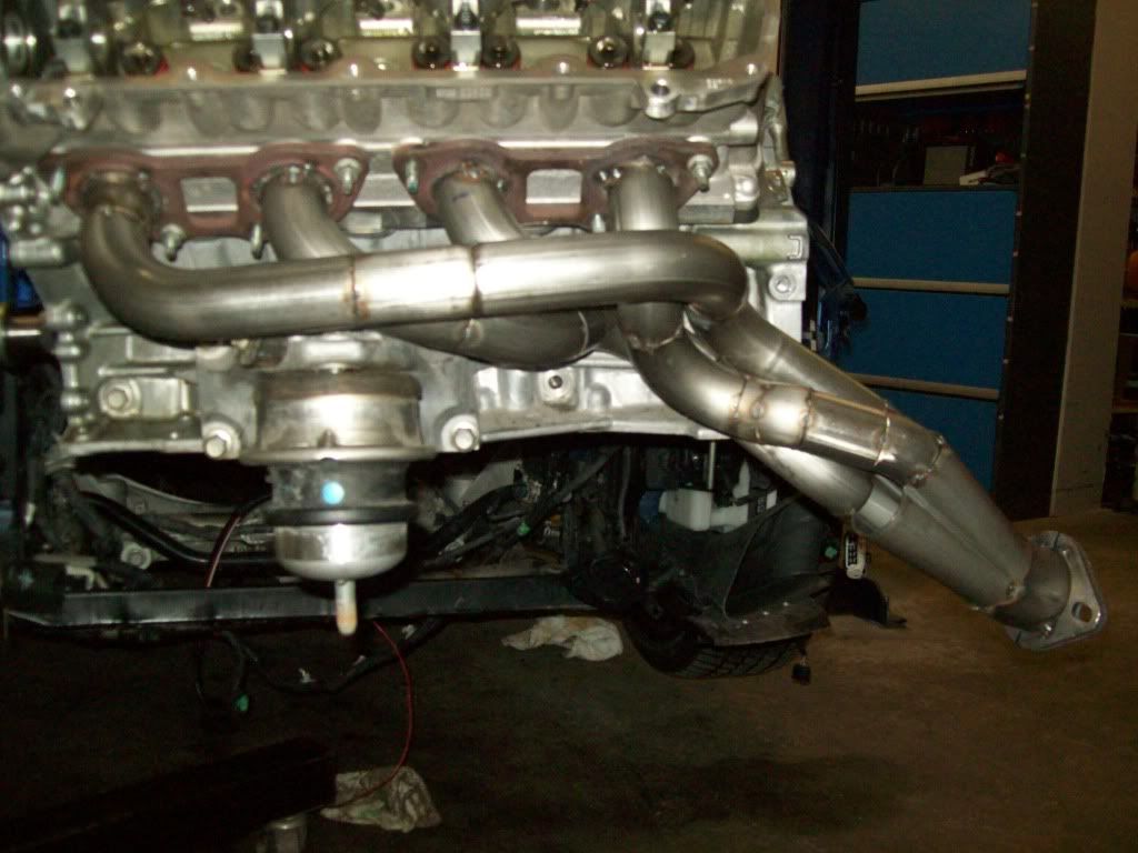

Here is a bit of a sneak peak! I have about 15 hours into what you see in this pic!! These things are tight! I was going for equal length, but I would have 300 hours into just one side if I go for that. Sooooooo........ I'm just going to do a nice flowing set of headers, I have done a bit of the math and it really shouldn't make that big of a difference in power. So here you go!

Looking good so far. So, will a free flow cat be attached to the end of each side, or are you just deleting the cats completely?
did you say not a big power differance?
