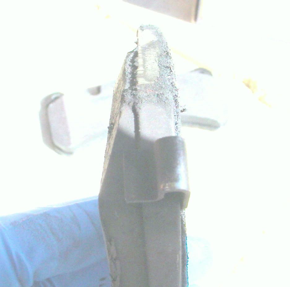

I changed my front pads at right under 24k miles with OEMs. I had 1mm left. Did the change myself and cleaned all of the pins, shims, and seating plate and applied the supplied Brembo anti-squeal. Measured the front rotors to be at ~45% thickness remaining. I have a set of Raybestos rotors ready to go when the originals are done. My rear pads and rotors are fine. And the best part is, I have no more brake squealing whatsoever!
