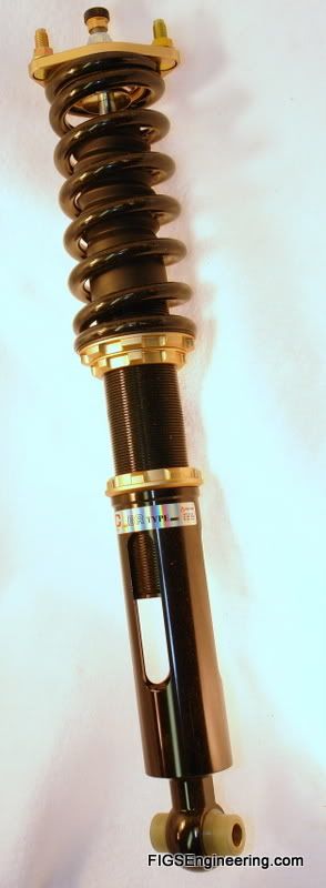

BC racing coiovers for the F just got them
9886 Views 24 Replies 10 Participants Last post by  Fig
BC racing coilovers for the F just got them
RETAIL $1250
Here are the pics. I may be able to install them in a week depending on what this next storm does.

They were purchaed directly from BC, hopefully my discretionary spring rate choices will work out well on the first shot, otherwise I may need another round of spring choices. As always I offer things with very low margin. My overhead is minimal and I do not believe in charging or paying retail for anything :)
In the insterest of teh experiment intially I will be running the car at stock height for comparison. Then I will probably lower and inch after that, it depends on my wheel choices down the road.
Fig, do you have any backround info on BC? Are they a part of a suspension company that has been around for a while operating under the BC name? I also was wondering what country they hail from? Those parts look really nice.
Champ, here is there site. They have been around since 1999 and heavily involved in the nissan and subi markets. Here is there site http://www.bcracing-na.com/index.html
I am pretty impressed with their product and price point and they had my attention at SEMA. No one else seemed to want to do anything for the F, so I have cooked up my own solution :) with their building blocks.

Well guys I thing my calculations have been rewarded. I just got done with the install yesterday. PITA trunk covers and plastic! The front took about 30 mins per side. The rear took about 2Hrs...lots of paneling to remove and I had to leave the wheel well covers off so I can play with the damping adjustment.
First impressions:
-Lexus must have used the same spring rate as the 350 but just cranked up the compression and rebound damping because the new stiffer springs offer tremendous control but no jarring impacts on small bumps.
-You feel a lot more of the road but the pillowball uppers also transmit slightly more high frequency noise from the road.
-While cracks in the road are still felt, the damping makes them less of an impact and more of a blip.
-My favorite canyon run was pretty exciting, even with snow tires. Previously I felt like I had no grip and was washing about, attributing it to the snow tire characteristics. But now I think it was more a combo between the snows and the soft springs.
-I am on somewhat stiff settings, 9 clicks from full hard, and pretty happy with the ride quality.
- I may want to make my own damping gasket for the interface between the chassis and the crown of the coilover just to filter some of that high freq noise, but other than that I am pretty stoked.
I will take some measurements and video for you guys. I have a vid from last night, but my canyon runs I ran out of mem space.
Full install DIY to come also.

Update from today. Damping settings now taken to 9 clicks out in front and 14 in the back. Overall the high frequency noise seems much lower and the ride more forgiving yet. This could be due to the pillow balls seating a bit, or the damping settings, it is not clear until I go back to the original settings. The increased control is also still present with these damping settings, body roll is still minimal. Still pleasant to drive although I now need to take an approach angle to enter the driveway.
I also confirmed the drop to be 1" front and .75 rear on a flat surface.
More updates to come as I walk through the settings.
